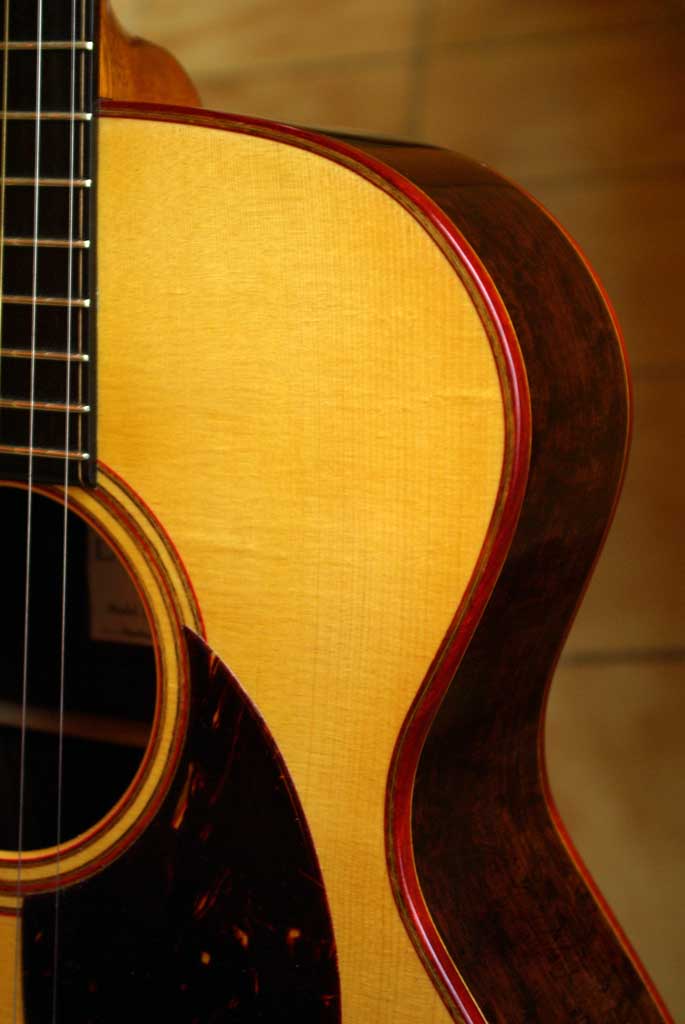

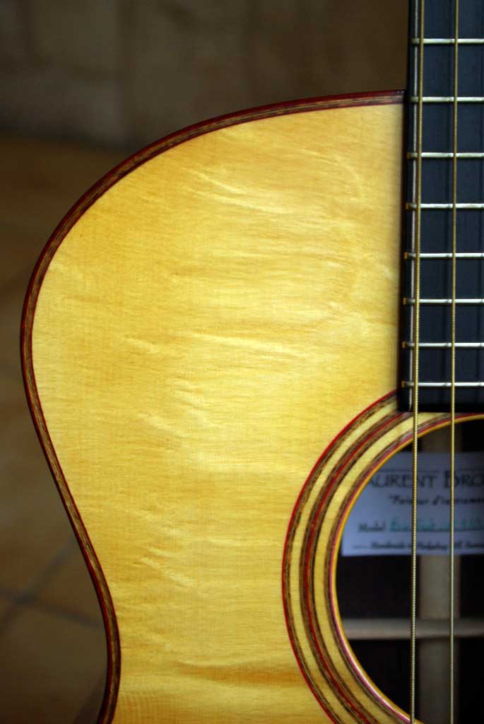

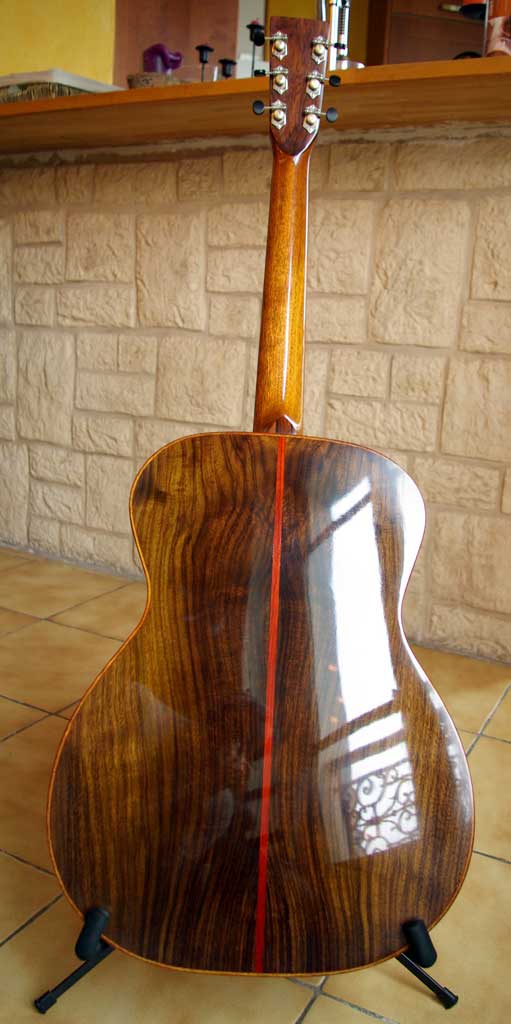

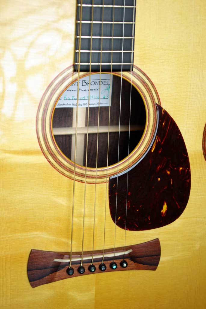

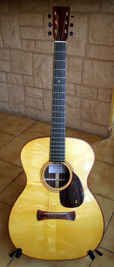

Hello folks, it's been a while since I've posted but last year has been
extremely busy with setting up a new shop and building 8 guitars. I also
started to work as part of Dana Bourgeois crew at Pantheon guitars here
in Lewiston, ME. Here are some pics of an OM I completed last October,
specs are German bearclaw spruce top, Indian rosewood back & sides, red
spruce bracing, mahogany neck, ebony fb, Madagascar RW bridge,
headplate and heel cap, bloodwood, flamed koa and maple trim, 25.7"
scale length, 1 3/4 nut width, 2 3/8 bridge string spacing, hand-applied
oil varnish.

Thanks all for the kind comments, you guys are too nice around here…
The bridge design is somewhat inspired by Stefan Sobell, also I thought
the larger wings would provide more support and contact with the x-
braces beneath. The bracing and top, although stiff, are very, very light…
Hersh the binding is "normal" thickness, meaning probably around .060".
The purfling is bloodwood line/koa/maple/koa/bloodwood binding.
For the oil varnish I used Behlen Rockhard out of the can for the first coat
over the shellac primer, and loosely mixed it with 1/4 turpentine, 5%
acetone and a drop or two of kerosene until if felt "right" for the
subsequent coats. I used a 2 1/2" hardware store brush suspended in
50/50 turpentine/mineral spirits solution between applications. I hand
sanded with a felt block and 320 grit sandpaper between coats. I ended
with between .002/.004 thickness. The most difficult is to work in a dust
free area (hard to do in a wood shop…), the varnish dries so slowly that
the brush strokes diseappear and even out, one has to work on a
technique to apply the varnish and avoid runs and sags at all cost though.
It is a very pleasnt process that I thoroughly enjoy. I loosely followed
Bruce Sexauer and Al Carruth descriptions of their varnish technique and
thank them for sharing. Final coat is wet sanded with 600 and 1000 grit
and buffed with fine and super-fine compound on my drill press.
Laurent Brondel
West Paris, Maine - USA
